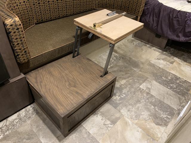

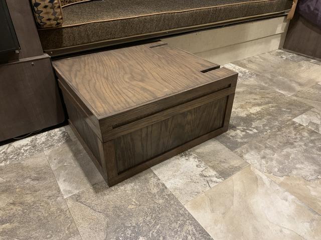

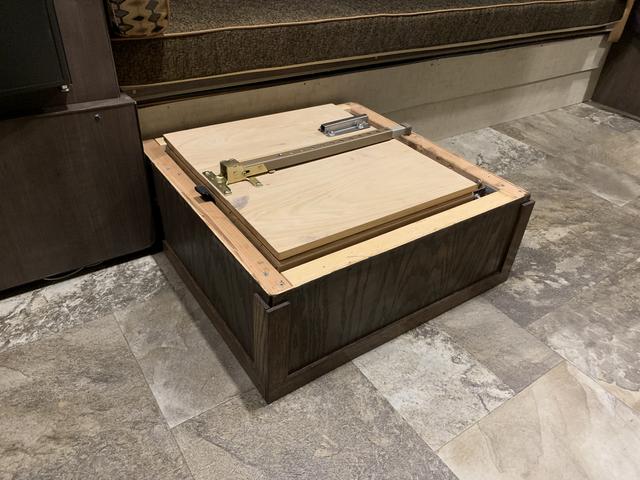

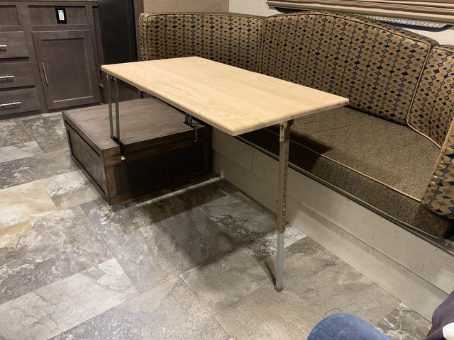

Here are my table mods. Decided to re-build the existing ottoman to incorporate a table. Got the idea from coffee tables that have a lift up top. The new ottoman is an inch shorter than the old one but about 6 inches wider. It needed to be wider to hold the arms that allow it to move up in position. I made the arms, table top,and box myself...as you can see, I’m not a steel worker or furniture maker:)I still need to make a new cushion for it.

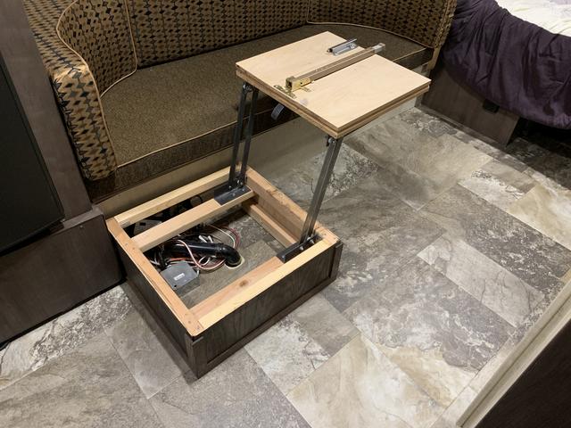

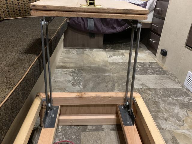

I would like to see more details for sure, such as the arm mechanism inside the new ottoman and under the table. I would be interested in reading how this performs in actual use also.

Here are some additional photos. You can buy arms off of different places like Amazon but the tallest I could find was about 11” and I needed at least 18” in order to comfortably slide in under the table so I just made them myself. Built a few prototypes out of cardboard first to make sure I understood the function and dimensions. The new ottoman is just 2”x3”, 1”x1” and oak veneer plywood. |

We never expect to have anyone sleep in that area. My wife telecommutes sometimes though so it could be a nice compact workstation for her (if I make the extension leg removable) as well as a larger dining area when extended. I can see replicating something very similar and at the same time building in my inverter and providing ventilation for it. Maybe also a slide in seat back for her to have back support working? It also solves my problem of having to flip the current table upside down on the bed so it doesn't slide around while towing on windy roads.
