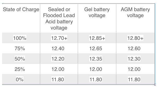

Get them on the charger and charge 'em up. Let them rest 24hrs (6-12hrs will give you idea) of if something is wrong. That rest period is important. You should have about 12.7v at hat point ![](uploads/7667/SOC%20by%20Voltage.png)
If you seeing an issue you can test cell by cell and confirm just how bad (like one is much worst than all others).
Much of this still depends on how you have treated (maintained your batteries).
Give it a run and let us know.

If you have or are able to eliminate the possibility of stray trailer loads then there is a capacity problem. 4 or 5 years is a pretty typical lifetime for lead acid batteries, they might be done. When you say they passed a load test what were they loaded with? The short duration load testers they use for SLI (starter, lights, ignition) auto batteries aren't meant to check capacity on deep cycle batts.
I'd suggest disconnecting them from any load in the trailer, charging them well, then put them on a known load for a known length of time. Group 27's should be good for 80-100 amphours, but try not to ever take them down that low. Take em down to 50% or so and use Olddawgsrule's chart.
