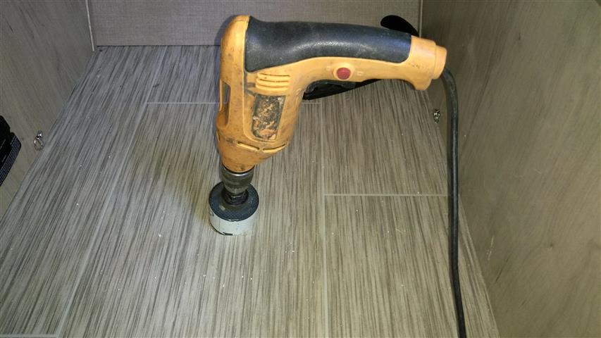

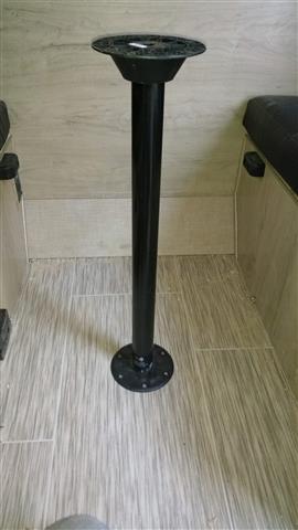

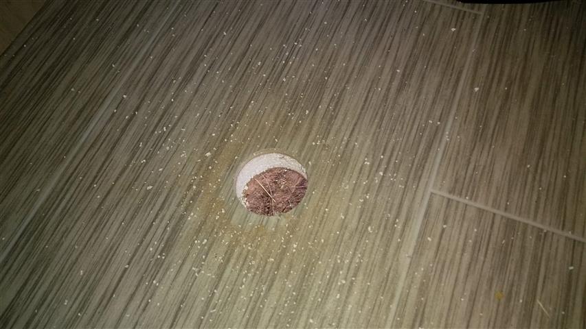

I chose the recessed pedestal mount, so I got to drill a large ugly hole in the floor of the new r-pod...yep...the floor is a styro sandwich.
