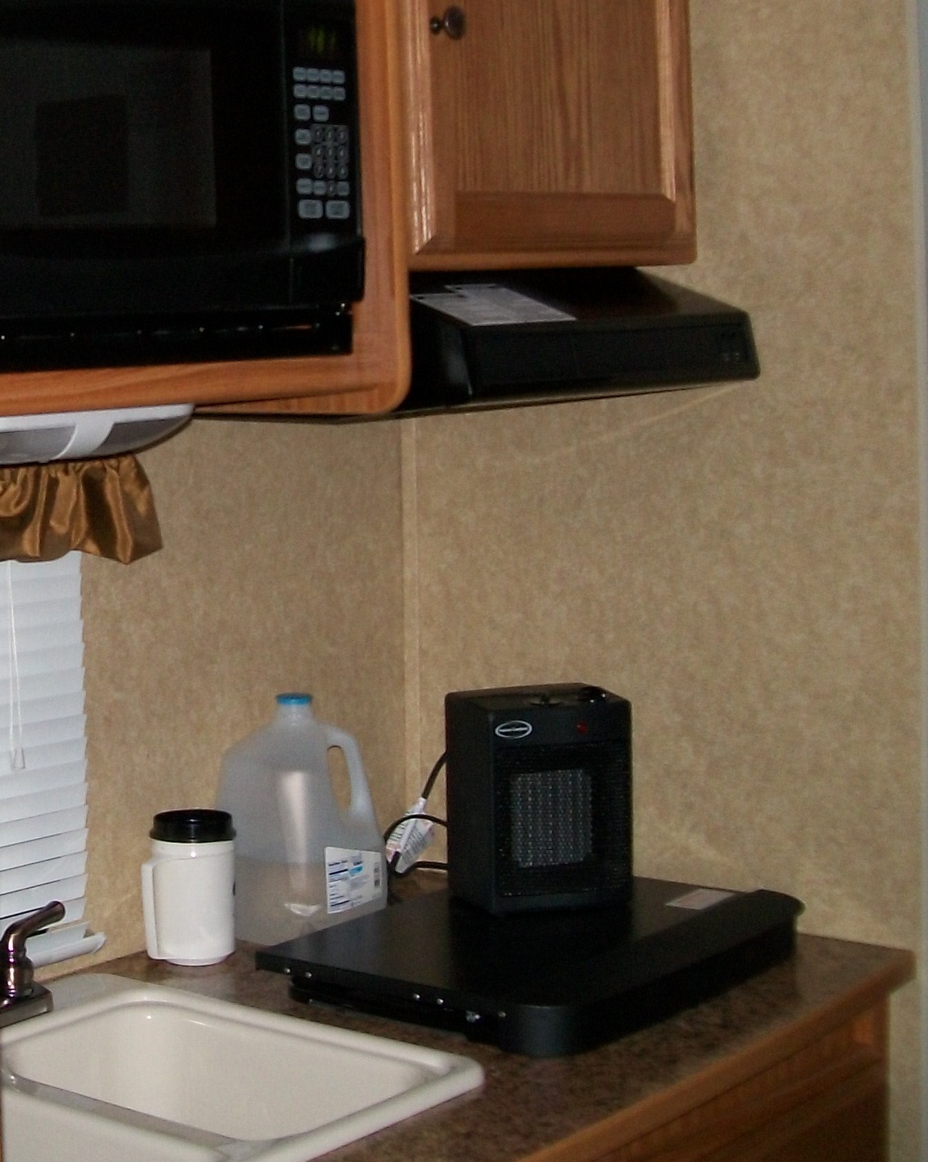

Posted: 19 Aug 2011 at 10:59am |
I don't have my heater here at the house and I don't remember the name of it. Its a little black box looking thing. It will shut off if it over heats, tip over switch, fan (3 speed) and thermostat. It stands about 1' high X 8" wide and 6" deep. I set it on the counter by the sink. It isn't loud and as long as it doesn't drop below freezing outside it will heat the camper.
Do a search for small electric space heaters. Terry |
