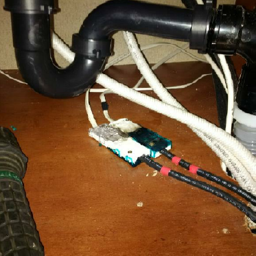

to the entire area. I was surprised to see that, directly under the p-trap for
the sink were two electrical connectors (see photo), clearly 115V. They were
blackened and broken. ![Shocked Shocked](smileys/smiley3.gif)
I also
noticed that the plastic drain fittings were dripping, and of course they were
dripping right onto the connectors! Since the plumbing is all “hand-tightened”
fittings, I assumed they had loosened off a bit with hot-cold and travel
vibration. It was easy to re-tighten by hand and stop the mild drippage that
had been taking place. It must have been recent, because while the area was
wet, it certainly wasn’t soaked and I couldn’t see any water damage other than
the burnt connectors.

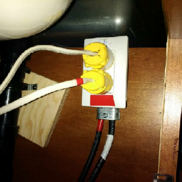

spent the rest of the trip on 12V and propane, which was fine. Once home, I was
able to affect repairs (see photo – overkill, I know. To do it again, I would
just make Marrette connections and tie them out of the way). One connection is
for the kitchen outlet (located in the slide-out wall) and the other is for the
microwave plug-in located in the overhead cabinet. But I will add that when
checking the entire electrical system, I noticed that the plug-in for the
microwave was incorrectly wired (hot and neutral reversed). This was preventing
the GFCI from resetting, so I knew something was wrong somewhere. I eventually corrected
this at my new plug-in arrangement, since it was really hard to access the
outlet. Note that, in my solution shown, those two outlets are electrically separate
(I broke off the tab that connects the “black” and “white” screws on the outlet’s
backside).
