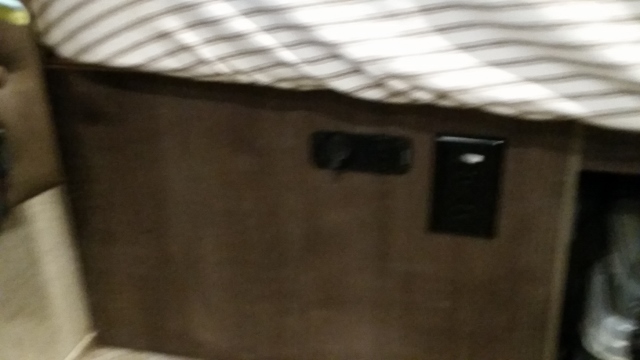

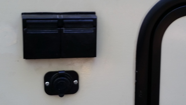

Thank you . You mentioned the 12 V outlets. Did you install them or the dealer? Can you also send me pictures of their locations within the RPod ?

I installed the plugs.  One plug is on the front of the galley cabinet below the sink, another is on the right side of the galley cabinet.  A third plug, along with USB plug is next to the 120V outlet below the bed.  The last one is below the 120V plug on the outside.  I ran a new circuit for the plugs from the distribution panel.
