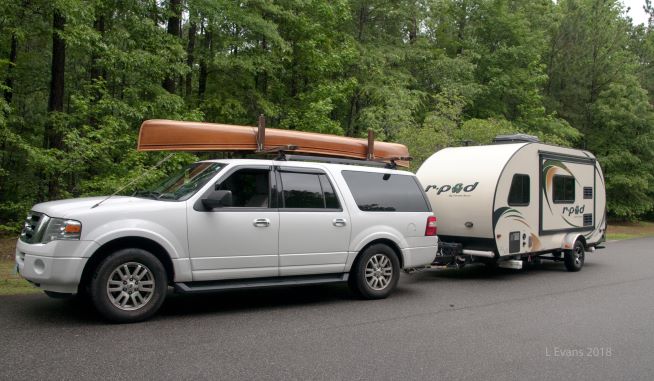

How about this?

We did several other exterior mods:
Installed a double step,
Added mud flaps
Added an exterior  door stop
Added a 6” PVC tube to carry our R Dome poles
Our Pod came with a Pahaque slide topper.  We added 2 bungee cords on each end to keep the flap in place
We added a 5” fence post for our sewer hose/fitting container.  Adjacent to the pipe carrier,  we attached a clear plastic, snap lid box that holds the clear 45 degree flusher fitting .
I added a small computer fan in the outside refrigerator compartment to evacuate the excess heat. It is wired in series with the existing fan and is temperature controlled.
Another fun exterior mod was to apply the frog paddler decal.  Since we are avid paddlers, some of our friends gave us a decal. So we can really confuse people as to which year/model we really have since our graphics are not stock!
I hope this gives you some ideas .  I will be happy to answer questions.
Safe travels.
Vann
