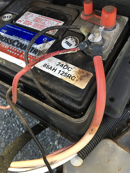

StephenH - "when comparing the typical 12V battery with a pair of GC-2 batteries,
the GC-2 batteries will be much heavier than a single 12V battery" This makes sense to me. I also see that the stock battery on my new 192 is a Marine battery, and I agree with your assessment that it is not true deep cycle. If I replace it with a 100Ah Lithium (not sure I would, but if I did upgrade, that is likely what I would consider) would the A/C charger be able to charge it, do you know?

There is a difference. Most RPods come with one group 24 size 12V battery. They are so-called marine batteries which are neither full-on starting batteries nor true deep cycle batteries. A GC-2 6V battery is significantly bigger and heavier than the typical battery. I won't argue the point that there are a few 12V batteries that are an exception, but when comparing the typical 12V battery with a pair of GC-2 batteries, the GC-2 batteries will be much heavier than a single 12V battery which is the usual set-up. An exception is the Trojan 12V battery at 85 pounds. Still the GC-2 batteries are about 60 pounds each so two of them will weigh in at about 120 pounds. That is a lot of lead. As for if they both were the same size, a 6V battery would have less dividers and likely have a bit more lead, but reality is that they are different sizes. Try to find a 20 hour rating on your 12V battery. You usually see cold cranking amperes, but not the 20 hour rate for 12V batteries.
