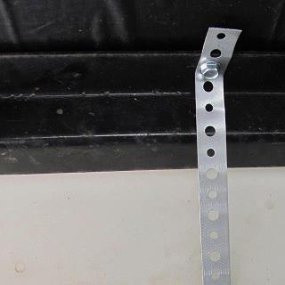

OK we fixed the water tank,and did a little mod to help hold it in.. what happened was the vent tube was plugged and when we filled the tank it expanded and "pushed" itself out of the channel iron that runs from frame rail to fram rail in the front and back of the tank.after we reinstalled the tank , i added galvanized plumbers strap that runs from the rear channel iron to the front channel in 3 places using self tapping screws , thus making a "cradle" to ad extra support when tank is full we have pictures but it says file size is to big and dont know how to make em smaller any help please

i think here are the photos on how i reinforced dads water tank. what happened was i put a regular hose in the filler neck with city water and with his vent pluggedthe tank expanded up and down enough to "pop"it out of its channels. i used ss plumbers strap, ss self tapping screws and ran 3 "straps" from front to rear so the tank cant "expand" and pop itself out again i hope thes pics download
