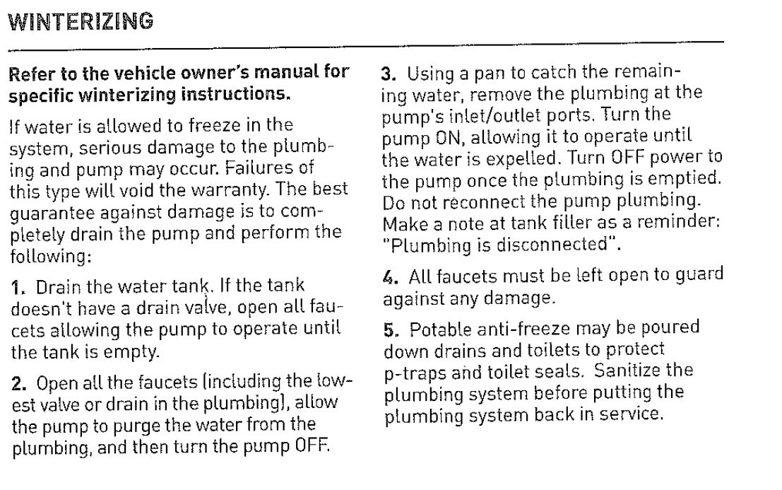

Here is the winterizing procedure straight from the Pentair Shurflo pump manual. |

Again, if you use the winterization valve/pickup line (I'm not talking about the bypass valves on the water heater) the pump will be full of antifreeze, so there is no need to disassemble anything. I've been doing winterizations for many years, with campers exposed to temps as low as -10 F, and I"ve never had a damaged water line, water heater, water pump, water tank, or valve. The winterization instructions posted on this site are the culmination of many people's input, and they don't include disassembling the pump. Trust me! |

Tech, I have no doubt that your procedures are sound and will prevent damage. The information posted is merely a factual alternative.
