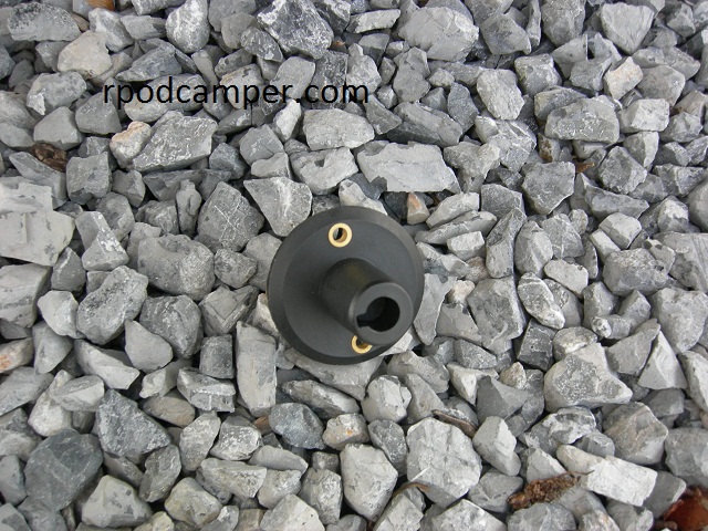

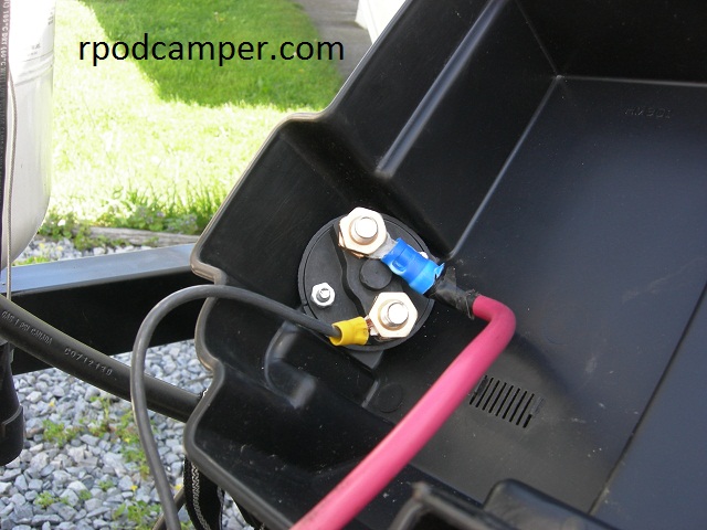

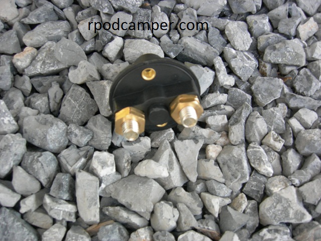

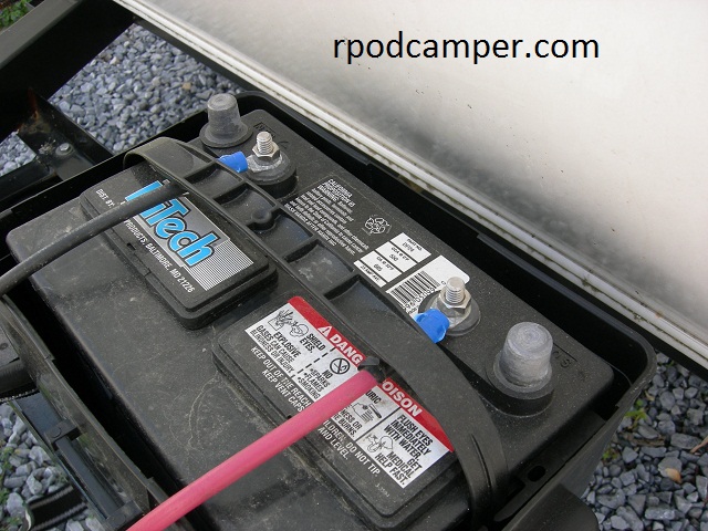

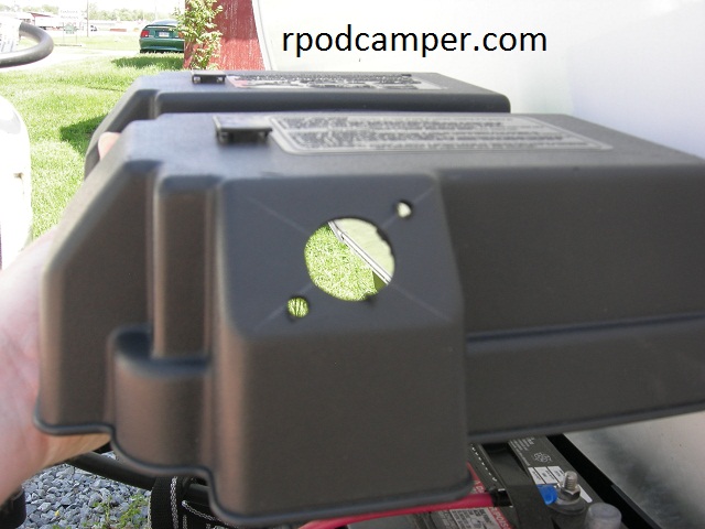

Been meaning to do this mod since last April. Finally got around to doing it this weekend. Installed a switch on the battery so that when the camper is not being used we can kill the current to anything that may drain the battery. This was also a good time to put holes in the bottom of the battery box to let any water drain that may get trapped in there. This was a pretty easy mod
1) take the lid off the battery box and disconnecting the positive battery terminal 2) Find a center spot on the lid to drill 3 holes (mine where 3/4" and 3/16"holes and finished up with a file) 3) install the switch using 2 bolts with lock washers to the lid 4) run a jump wire from one side of the switch to the positive side of the battery 5) connect the wire you had removed from the positive terminal of the battery to the other side of the switch. 6) Install cover back on the battery box and remember to put the safety strap back on the battery The switch is only on when the key is in and turned on. |
