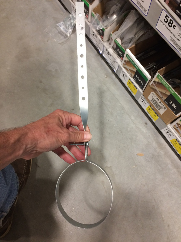

I created a black tank drain support for my 2019 R-Pod 191 today. I got the idea from different people here, thank you for sharing I hope it will stave off a disaster down the road (literally!). Thumbs Up
I examined the bolts and brackets on my black tank hanger and it does have a nylon lock washer bolt on there. I thought someone had mentioned they did not, so maybe FR changed that based on customer "feedback". Censored
Anyhow, I chose to use a conventional 3 inch galvanized pipe hanger available at Lowes. It was less than $2 and then I used a stainless nylon nut and a few stainless washers to hang it. I cut the hanger to fit the outside collar of the tube and bend the top inch over for strength then drilled a 7/16 inch hole. I am using a frame bolt to suspend it. It is hanging down about an inch forward of the tube.
I used some 1 inch black foam adhesive weather seal around the tube to offer cushion and prevent the hanger from rubbing/cutting in to the plastic pipe. I painted the hanger with black Rustoleum to match. I will keep an eye on it and hope it acts as a backup in case the factory one fails.
Check it out and tell me what you think...

Here it is in place:
From the side:

I hope it works well. It is somewhat different than what I did with was to use anodized aluminum strap material and use the self-tapping screws to fasten it to the frame in place of the failed factory strap. I did not fasten it to the pipe nor put any padding in, but it is rubbing on a thicker part of the valve body. It has gone through a number of miles and does not show any signs of weakness. Hopefully, you will never experience a failure. I have--twice! Angry

Sorry to hear that. Nothing is worse than something brand new falling apart because it's made like junk. All it would take is a heavier duty bracket assembly from the start. I think you can contact FR parts department and buy it from them. Most of the parts on that section look like standard RV parts if you can find another supplier. Like StephenH listed here on Amazon. Probably a lot cheaper than FR too. But just in case:

Thanks for the words of encouragement. Once I got down and removed the 3” waste valve, I saw that the flange connection to the pipe is still good...whew. I searched around and found the best deal on eBay...$21 for the waste valve, cap and flange.  Thinks I’ll go with Wirats hanger...cheap, easy and simple...these things are common in the plumbing world.  Gonna replace both waste drain hangers and I will be good to go. Moral of the story: be proactive and eliminate those “ industry standards conceived by some pin head engineer”...Zip ties don’t leave home without them. Love this site good stuff here THANKS ALL
