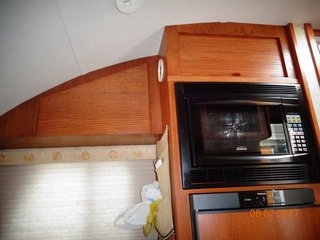

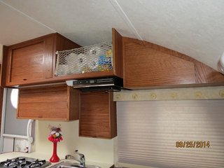

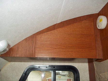

 I have 172, and have only 2 side windows but I built cabinets above them

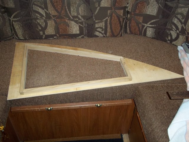

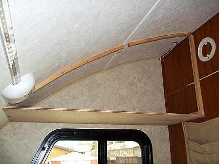

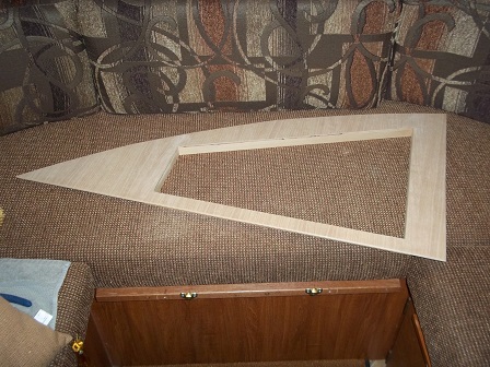

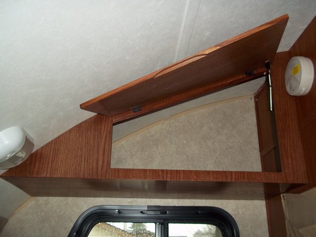

 Bottoms and doors are 1/2" oak plywood, fronts are 1/4" plywood. the valences are attached to the bottoms. I used coarse thread drywall screws, but predrill 1/16" into skin, use a hand screwdriver, you don't want to overturn them.
Direct Link To This Post Posted: 14 Mar 2021 at 8:08pm

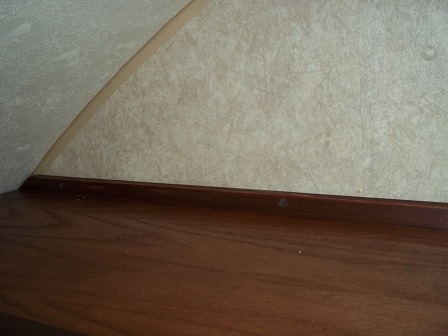

The bottom shelf has a cleat on the back.

marwayne nice job, it looks really well matched.
