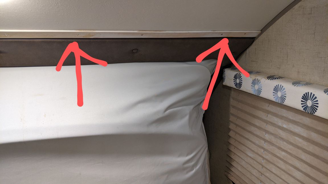

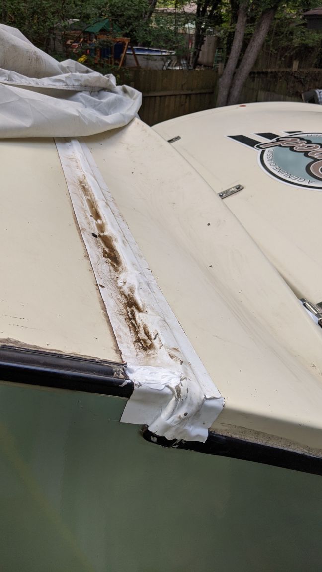

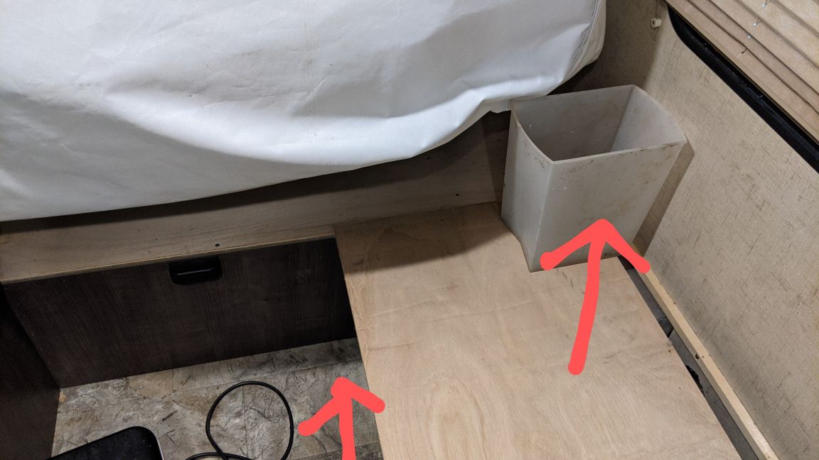

Hey guys, I really need some help. I have a leak near the spoiler on my 176T (this is the model that has the bed that folds out the back. The spoiler is different than the spoilers I see on the other models. The leak is coming out of the areas inside marked with the red arrows. It does not appear to be going in to the wall, I can see no evidence of delamination or water issues in the outside walls of the Rpod. It is landing on the floor in the RV where the red arrows show. I sincerely thought it was coming from the seam where the spoiler meets the roof, but I have already used the Eternabond tape to seal that seam and it seems to have made no difference in the leak (see pictures). Questions:
1) If someone has had the same leak, can you please help me find it? 2) Has anyone pealed the inside roof back on an Rpod in order to find a leak? Where did you find replacement materials to redo the interior after you demo'd that out? 3) It seems impossible to me that it is coming from the AC seal or the vent tube from the bathroom because there are no other drips coming from the ceiling between the AC and the rear of the Rpod, and also the bathroom vent tube is on the opposite side of the leak. Is it possible though that the leak is coming from the AC and running all the way back to the bed area? Thanks in advance, J

Thank you for the replies! The hinge bolts on the cover pierce through the fiberglass, towards the inside of the cabin, I thought that was the leak at one point, but then I etenrabonded over the bolts/hinge and it didn't fix it... The gap between the door on the back of the rpod is a possible entry point, but it would also cause water to leak on to the tent that is folded up back there, and there is no water getting in there, so I don't think that is the cause. I think it is more likely something on the roof itself that is leaking. That is why I was hoping another 176T owner had already been through this and isolated the location.

Really appreciate the help guys. I ended up taking a garbage bag and some foil tape (used for sealing AC vents- very sticky and easy to tear) and taped off selective areas of the roof to find the leak. I then used a hose and soaked it and eventually pinpointed the leak. It was not coming from the area covered by the eternabond- so that seal does appear to be working. It was coming from the area where the black screw cover meets the spoiler. There is this little dome of black plastic that covers the screws that run the whole edge of the roof. That area has a channel that allows any water that slips through to drain right near where the eternabond seal is at the spoiler seam. The water was going down in to that channel, and there was a screw in there that was never sealed from the factory... so it was dripping down in to the RV, then running down the wood post on the ceiling... Sealed that up and stopped the leak. I think it has been like that since it came from the factory... so lame. Anyway, hope anyone with this issue might find this breadcrumb trail and it ends up helping someone else... Thanks again for the moral support and hints.
