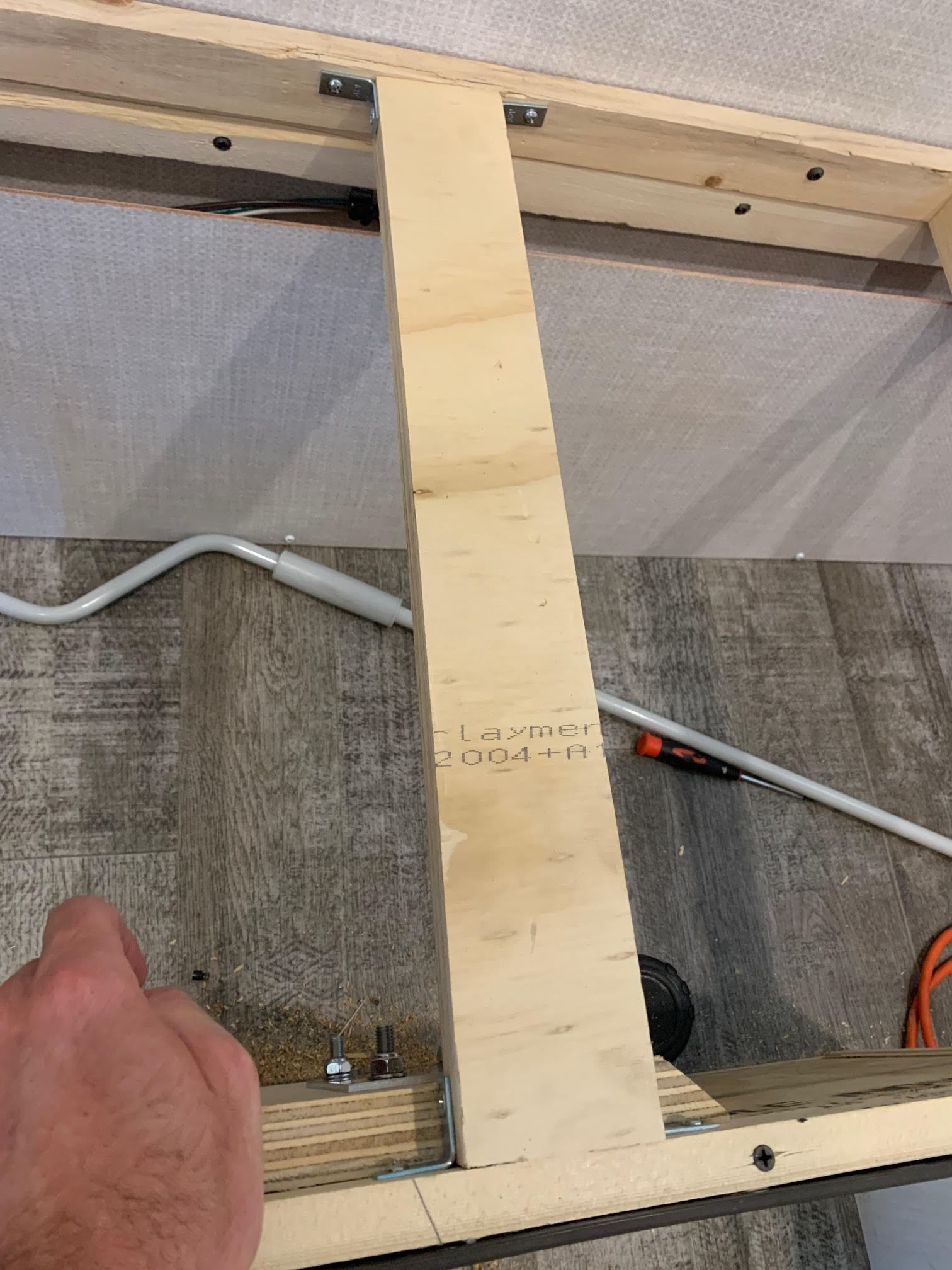

Hey podders!  I just installed a lagun style table - Will add in some pics (Obviously had to re-enforce) all the backing but I'm looking for a source for the replacement (just shy) of 28" x 28" table top.  I came across the "Lama-Light" type stuff but that specific vendor is 2 months out.  Does anyone have any suggestions for other vendors and have recieved some lightweight table tops?

I used my stock top so I can still set up the bed if needed.
Here is the mount I made.

Good job, clean and stout.  Did you do the fabrication?

Post Options Post Options   Quote Toyanvil Quote  Post ReplyReply Direct Link To This Post Posted: 22 Oct 2021 at 10:35pm
Thank you, yes.
