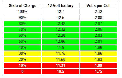

+1 Great advice above. Also I had this happen when one of my connections at the battery was snug but not tight. Make sure the connections are tight with a wrench, not just finger tight. Also pick up a multitestor/voltmeter (Harbor Freight $4-5) and check the battery voltage. Fully charged at rest a 12v will read 12.72v or above. If it is reading under 12.1v the battery either needs to be charged or has been hurt in the past. Give it a charge and see after a day if it holds that charge using the voltmeter.
