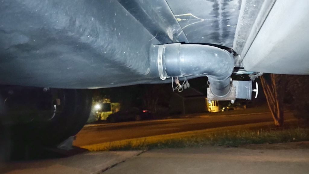

If it would fit, I'd be inclined to put something like this on the connection: https://www.supplyhouse.com/Fernco-1056-44RC-4-x-4-Strong-Back-PVC-Shielded-Coupling-Connects-Cast-Iron-PVC-Copper-Steel-or-Lead?utm_source=google_ad&utm_medium=Shopping_tm&utm_campaign=Shopping_TM_New_users&gclid=CjwKCAjwm8WZBhBUEiwA178UnHYI9_NtxOcdD7gCmEZps7T8JF5w1_eV54V78-t7pU4frvLEjBdsMxoCVqkQAvD_BwE

Okay I gotcha. Yeah that was no where to be seen. I discovered it when I was just about to back in and park. It had been detached completely and dragging for an unknown amount of time
By the metal hanger on the valve end. I reached out to the dealer already. I honestly can’t say for sure if that clamp was on there or not to begin with. Thank you for the photo and information! |

podders Helping podders - pHp Joined: 29 Nov 2015 Location: Wake Forest, NC Online Status: Offline Posts: 6294 |
Post Options Quote Reply Posted: 25 Sep 2022 at 10:27pm |
As you can see, mine has a worm drive hose clamp. Was the pipe totally separated or partially attached when you discovered it? If it was totally separated, it could have fallen off. If it was partially attached still, then it may not have been installed at the factory. If your 'Pod is still under warranty, check with your dealer about repair. If you are doing it yourself, then add a hose clamp when you reassemble it. I don't know what kind of sealant that was used, but apparently it is insufficient by itself.
