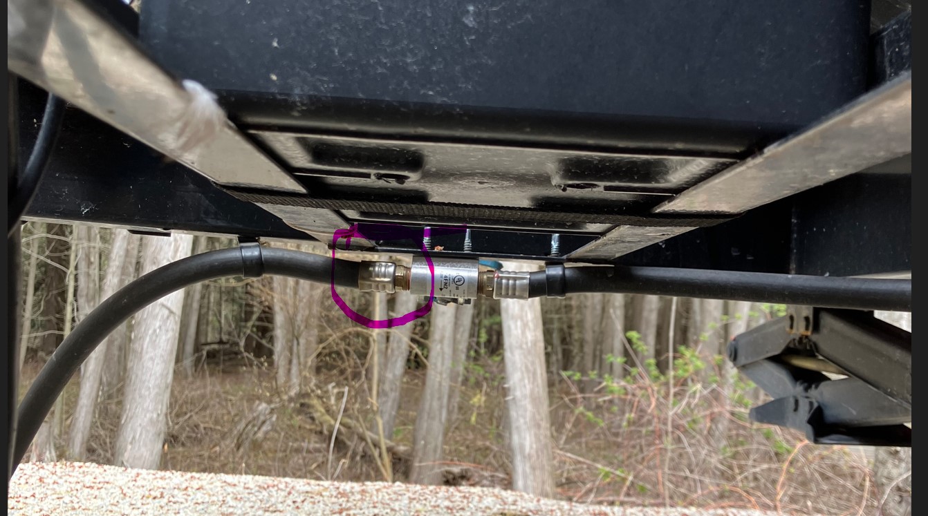

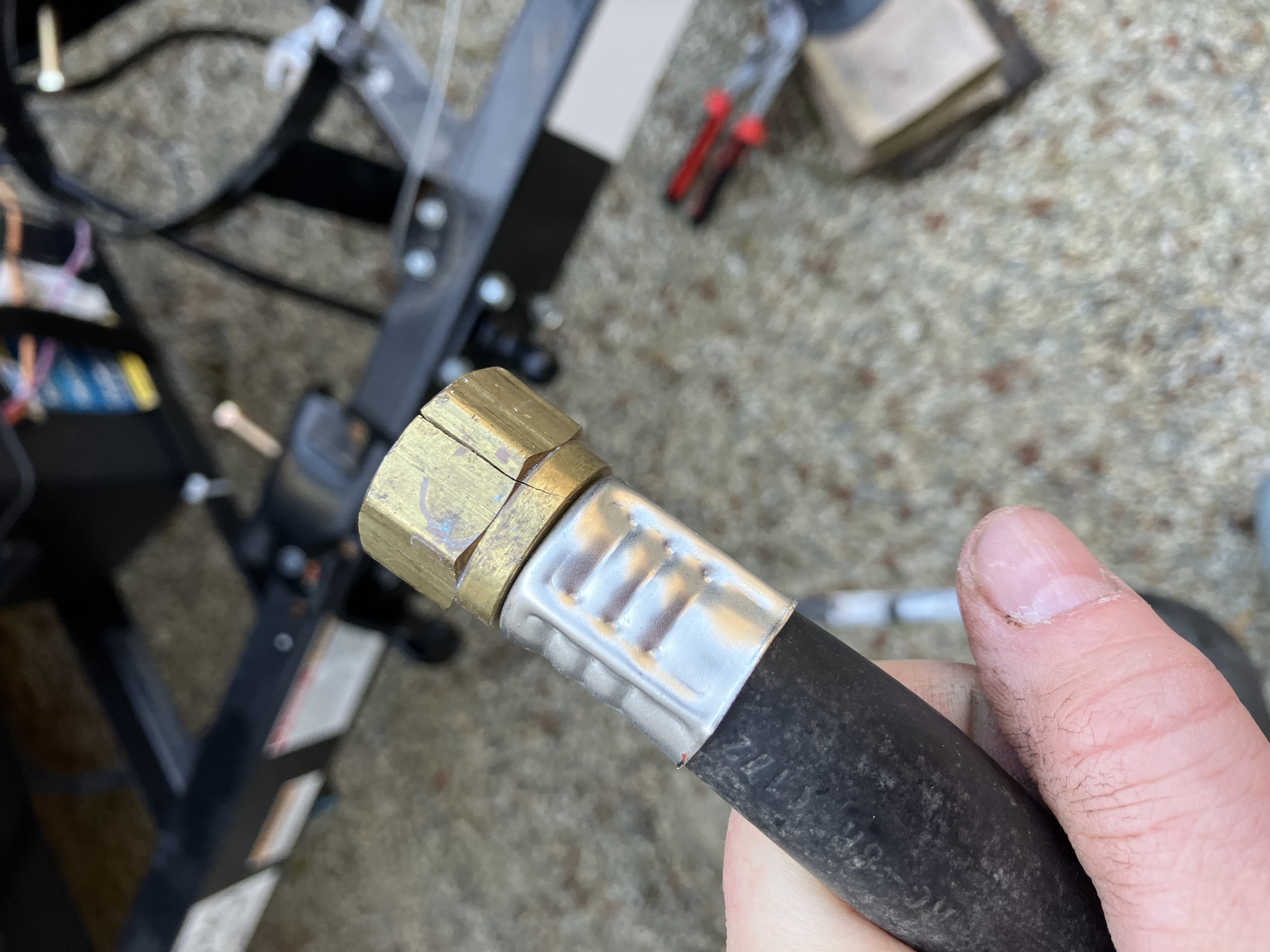

Is there a trick or tip to get this hose off? It's turned on tight and I need to replace it due to the cracked end you see in the picture. Thanks in advance!

If that end doesn't have a swivel fitting remove the other end first.  Then on the pic you show above, take a pipe wrench and place it on the union that is holding both hoses together.  Then take your open end wrench on the hose with the cracked fitting and turn it counter-clockwise to remove.  It may take some effort as it appears the previous person over tightened it, causing the fitting to crack.
