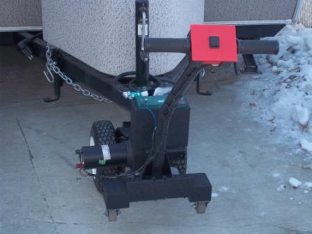

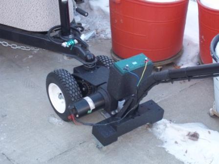

Doug: I bought a trailer dolly from princess auto on sale for 300$. It is a very poor design and very insufficient for my purpose. It would not even push the trailer down the driveway over a 1/2" lip, because the weight was distributed over 3 wheels. I used the parts from the dolly, made and bought others and by trail and error came up with this design. Total cost about 550$, consider this thow with this dolly I can manoeuvre the pod through a gate behind the garage with 4" of clearense and save 80$ a month on rent for storage.
From this to This I also geared down the speed from 24 to 14' per minute for more torque.
Posted: 15 Feb 2012 at 8:08pm |
Very sweet. If I had an extra couple of grand I would build an electric pusher for my car, partly just for the fun of building it. I figure it would increase my MPGs by 50%. Did you salvage the motor from something? |
