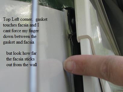

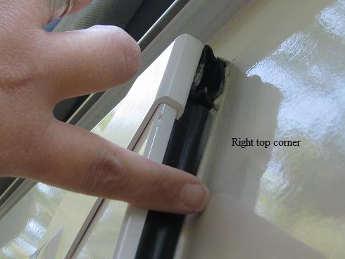

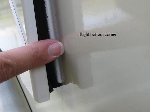

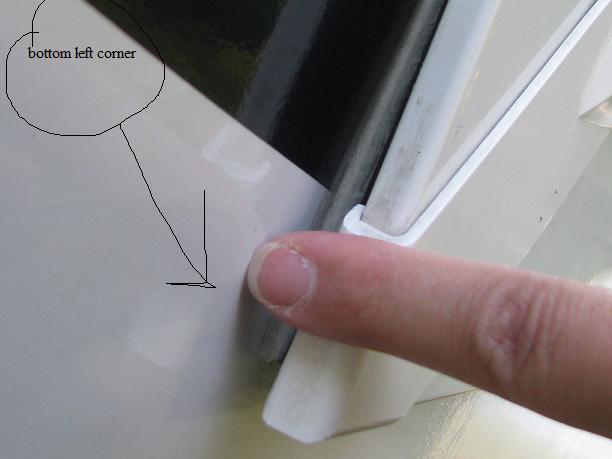

It
seals all around but at the top right corner even though the black
gasket touches the fascia, I can wiggle my finger in between the gasket
and the fascia, and the bottom seal is being pinched and
sticking out below the bottom fascia. I cant do this with any other side. Also the bottom fascia bows
outward when we close the camper and so does the top fascia even though
it does not push against the gasket as tightly as the bottom.This was
not doing this when we bought it a month ago so
I am at a loss as to why it is doing it now.

basically the top is not putting as much pressure against the gasket as the bottom and the bottom is putting so much that it is pinching the seal

I noticed on my 176t that I could "over drive" the push out going in and going out. This caused the push out to rotate slightly top-to-bottom when it reached the out or in positions. This caused the rubber seals to NOT seal effectively.
Consequently, I now watch the push out carefully when I close it or extend it and STOP pushing the elec. buttom just before it rotates. This takes some practice, but provides a better seating of the seals. I hope this helps

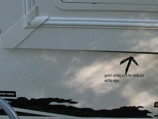

I just bought a 177 today and noticed the following: the left side gasket distance from the side to slide is 1/2" looks good. On the right side the top and bottom distance from the side to the slide is 13/16" from the top and bottom but 5/16" in the middle. A straight edge three feet long really shows the gap. I was told it will be ok. After measuring I'm not so sure. Did you have any resolution to this issue?

I corrected my slide-out gasket problem the same way as BILL-GA did. If you over-drive the motor, the slide-out will over compress at the bottom while at the same time de-compressing at the top.
I use a gasket rubber lubricant to keep the gaskets soft. I also carefully watch the gaskets from the interior as I run the slide-out in. I can usually see and hear when the bottom gasket of the slide-out makes contact. I then stop the motor. The top gasket is then compressed about the same as the bottom. If I keep the motor running until it sounds like it is going to stall...the top of the slide-out rotates outward while the bottom is over-compressed. It takes some practice to just let the bottom make contact without overpowering the unit. |

We were told by forest river to adjust the stopper, which I guess it coincides with Bill's fix. It is a simple system, the whole slideout box bolts on to a horizontal metal plank with with either two or four bolts then this plank bolts to a floor stand with two bolts that allows vertical adjustments, then the stand bolts to the floor with two bolts and two bolts to the side wall right below the slideout opening.
