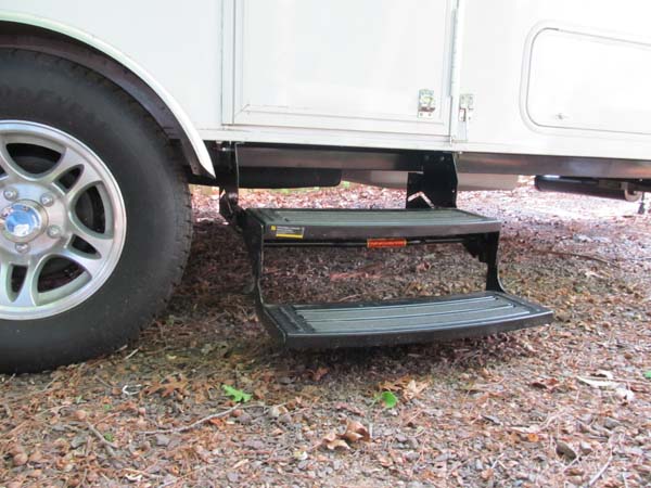

Yes, we installed the double step.
I am very pleased with the final product and it has made a big difference. BUT it had to be modified to fit correctly. I will gather the information for you and tell you what we did.
Leaflin
Newbie Joined: 19 Nov 2009 Location: Virginia Online Status: Offline Posts: 24 |
Posted: 29 May 2012 at 8:39pm |

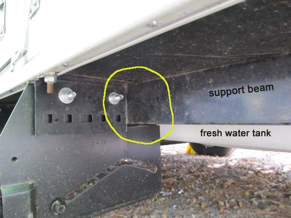

The steps we bought are made by Stromberg Carlson. I got ours from etrailer.com. They were the lowest price, plus I got free shipping as I also ordered some other stuff. http://www.etrailer.com/Enclosed-Trailer-Parts/Stromberg-Carlson/SM-24-20.html Now the bad news. The
steps won’t go back far enough as they are blocked by the support beam. Using
a hacksaw, Brian, my husband, cut a 4 x 4 inch square (approximately) out of the
back top on each side. He
said it is relatively soft and on a scale of 1 to 10 is about a 6 in difficulty. After
he got a good fit he had to drill new holes for the bolts in both step and
support brackets. He also added extra washers for a tight fit.
I
think it was worth it because all I had to do was order the step and provide “Atta’
Boy” support! |

================================== Just finished installing the Stromberg 2-Steps. That's some HARD steel - - but thank goodness I had a metal blade for my recip saw. Got lucky with the first cuts ...but the tolerances on those Stromberg steps is tight. I had to do some mild bending to get the stairs to work smoothly. Really like the extra step though. The effort was well worth it in the end. MJ |
