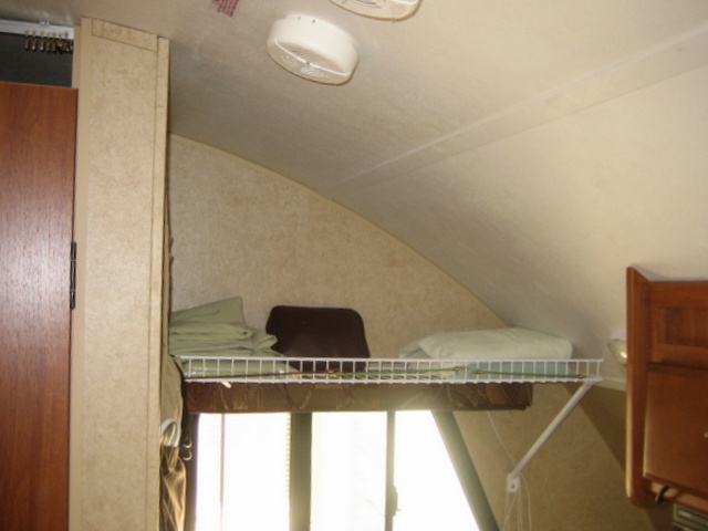

================================================= Here is a shelf I installed in our 177. It is an "Off the Shelf" (no play on words intende) 36" Rubbermaid wire shelf unit from Ace Hardware. I mounted the shelf upside down, so that there would be a "lip" at the edge to hold things in place and we we little bungees to secure stuff during travel. I had to take a pliers and bend the brackets a bit but otherwise it's just like it came. Give us a place for linnens and light duffels. Took me about a half hour in install ... 'Slogger |
