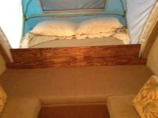

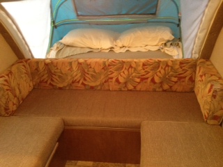

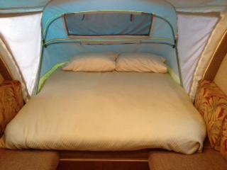

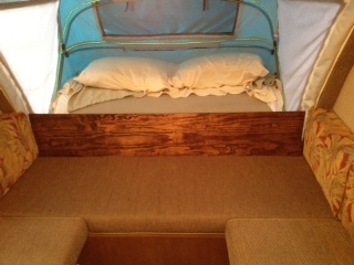

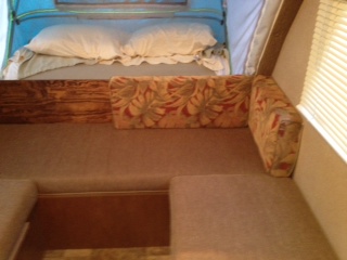

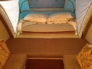

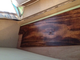

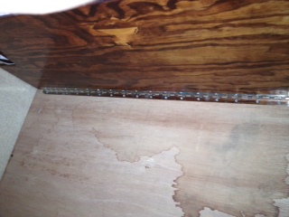

We took delivery of our 176T on August 11 and immediately started to do some mods to it (some that we read here and others that we figured out on our own).  One of the best mods was one that we came up with to make the dinette a LOT more usefull and one that, honestly, FR should have thought of on their own as well.  With the bed folded into the tent end, the dinette was not really very comfortable to sit (no backing to sit against) on if one wanted to watch TV or just sit and relax.  Rather than try to explain, I will let the pictures do the talkin!
Bed out and ready to be put away for the day.
Bed folded up and dinette is shown as FR designed (table removed for photos)
Now comes the fun part!  Pull up the long cushion to reveal the mod!
Now fold up the backboard to its upright position (piano hinge shown)
Replace the large bottom cushion to hold the backboard in the up position
replace the small side cushions
Then put the long back cushions in place
We are currently using our pillows to fill in where the long cushions normally reside
Now it is time to relax and 4 or more can very easily sit here and comfortably!
But we have extra cushions on order from FR.  We saw Cody from FR at the Hershey show a few weeks ago and asked him why FR had not done anything to make the dinette in the tent models more usable.  He stated that they have been trying but had not come up with a viable solution as of yet.  We showed him our photos and he asked for them.  A follow up phone call and FR is going to be building a prototype of this on their next run!!!!  Always exciting when we can add to the betterment of our little campers!
