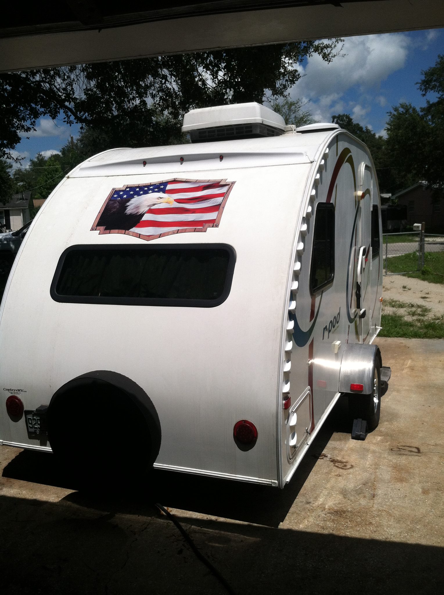

I hope all can see them botton of picture is a slide not to good at adding pictures, Just got back from a trip, lots of rain you can see back is not to dirty,tabs help that, will let all know about fuel savings when my son get all the numbers.

Air tabs been using them for several months have not been a long trip until past week went on a 550mile round trip,and averaged .4 miles per gal increase,on a long haul say 1000 miles or more its a little savings, the tabs almost stop the pushing effect or sway when being passed by bigger truck,rear of trailor stays cleaner you can see the swirl behind you when pulling in the rain,I USED a total of 32 tabs,16 ea side bought 5 extra,just in case total cost $114.42,w freight.Ea tab costs $2.75. HOPE this is helpful and you can understand me. thanks

The tabs look similar to vortex generators on some aircraft, these generate turbulence and break up the flow of air for specific purposes. I don't see how disturbing the air flow at the back of the pod could help induced drag. I agree with many that the problem is the shape of the front of the pod and the distance between the T.V. and the front of the pod, this area is subject to a vacuum and turbulence and increases induced drag. I don't care, its still fun and cool looking.

I did road tests and computer simulations on airflow over my vehicle and r-pod several years ago. The gap between the vehicle and the front of the r-pod really didn't create significant drag. The problem area was created directly behind the r-pod: fast moving air travelled along the roof slammed down to the ground immediately behind the trailer and created a large swirling vortex of low pressure about 5' high behind the trailer.
Next time you're pulling the trailer in the rain/drizzle, watch around the rear of the trailer in your mirrors - you can see the maelstrom that's created back there. In reality, the r-pod's shape creates far from a sleek slipstream. I think that Doug's approach for a squared-off rear (or maybe something more rounded-off and airstream-ish) would likely perform much better. Question for rex: Have you tried the air tabs across the top of your trailer? I suspect that installing them along the rear edge of the air conditioner (and extending that line across the top of the trailer) would yield the best results.
