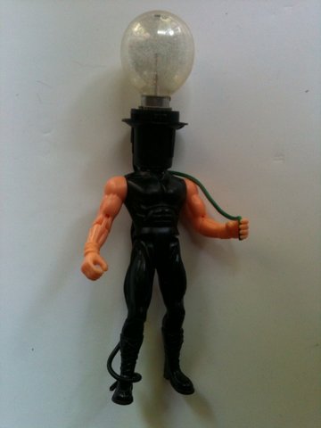

Yeah, you really don't want to use yourself as the test subject. Here's a picture of "Flash" who is an action figure (not a doll) I built with a flash bulb for a head. Yes, you can still buy flashbulbs for $1 on eBay and they go off with a big "whoosh". I use Flash in my No~Shock~Zone seminars to demonstrate what happens when you get across a voltage and ground source at the same time. He's OK with it since I can always pop in a new flashbulb. But you may not be so lucky if you get sufficient current across your heart. If you ever feel ANY shock from an appliance or RV, no matter how small, stop immediately and power down. And read all my electrical safety articles at www.NoShockZone.org for a better understanding of electricity and how it works. |
