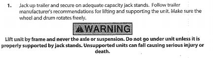

I have been pondering this very same question, but, I must say the information I have received so far is mixed. None of the FR documentation indicates where the lift points are on the trailer. I asked my service tech at my dealer and the answer was "any where on the frame". Another school of thought is on the axle. We all know how the generic FR camper manual falls seriously short of satisfying POD owners. However, I was very surprised to learn that FR provided absolutely no guidance on this very important safety issue, where are the lifting points on the trailer? Whoever is keeping a list for FR improvements and/or things owners would like to see fixed, I think this is a good one. There is one hint hidden deep on page 60 of the "Lippert Components Towable RV Master Manual" that states "Follow trailer manufacturer's recommendations for lifting and supporting..." that don't seem to exits, but then on the next breath issues a warning to never lift by the axle.

The consensus here over the years is dont lift via the frame, and use wood under the axle, as mentioned.
Podster
Posted: 13 Oct 2014 at 7:49pm | |
Well, I confirmed this with Forest River-R-Pod Service Division. The recommendation is to jack on the axle even though the axle manual says to NEVER lift via the axle. Rhetorically of course, is it to much to ask FR to issue lifting point guidance on their vehicle? Thanks for your help on this Tech...I appreciate it.

I've watched Forest River actually change someones tire, on the axle right at the connection point to the frame is what they did and advised others to do. But I still go with levitation with mine!
