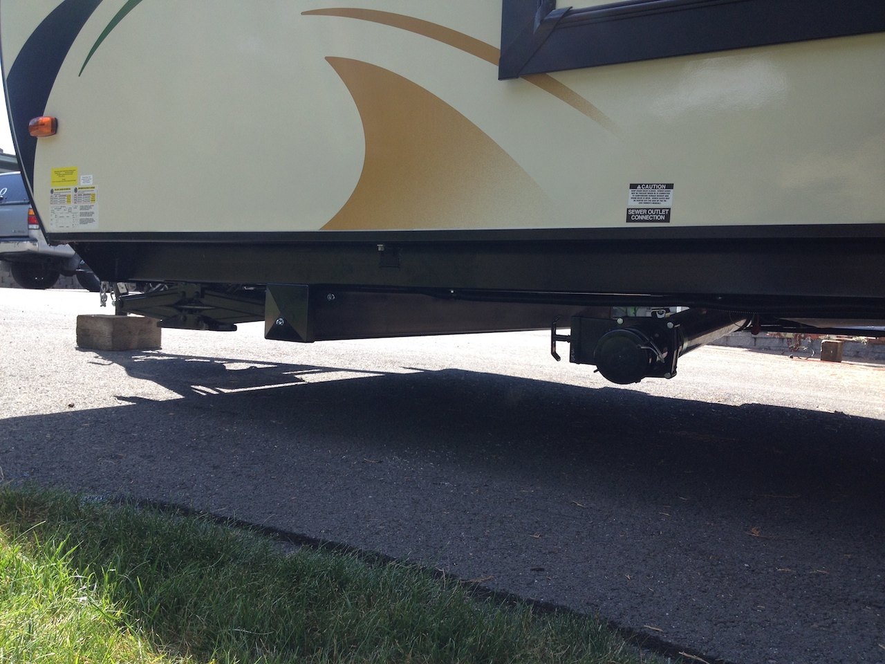

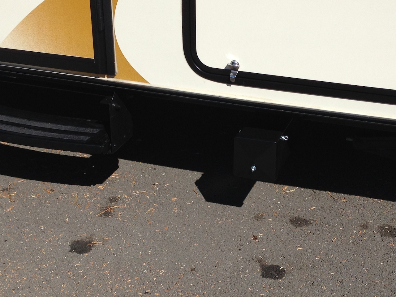

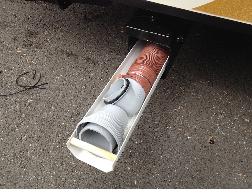

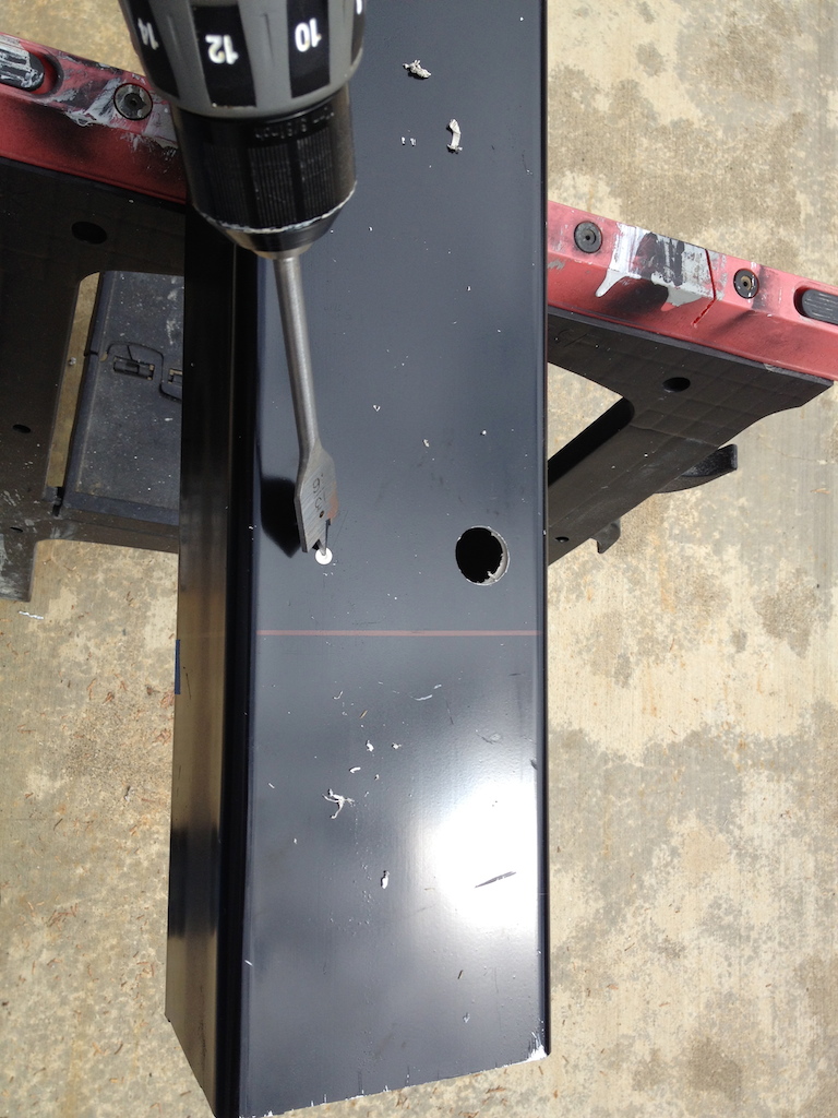

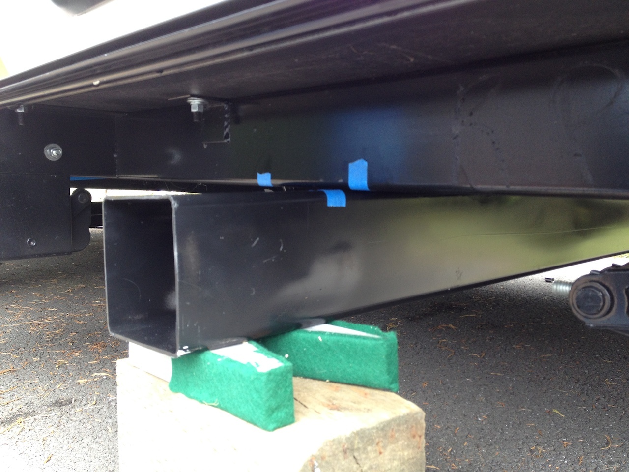

I was looking for a better way to store my sewer hose. I saw on other RV forums where folks used a 5x5 PVC fence post with a PVC Gutter as a slide out. A simple dowel cut for a handle, screwed in from the sides. It also doubles as a sewer line support if needed. I saw many ways to attach the PVC Post, but ended up just bolting it to the frame with a washer/bolt. Used it the first time this weekend, man it works great!!!! Doesn't look too bad either. Has room to store my 90 degree attachment as well... Here are the pictures... The end caps are held on with small bungie cords to eyelets. Whole thing cost me about $48, parts at Home Depoe for the PVC, local hardware store for nuts & bolts... Only adjustment I had to make was move a Propane line clamp attachment forward about 3-4 inches (EASY).

Most pics didn't load... Here is a completed shot

Really nice work!!
