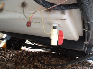

I have 2 suggestions fo degrees.r you regarding the fresh water drain plug- if you are worried about leaks or see a small leak you can easily wrap the plug with a couple of wraps of plumber's teflon tape . but i think a better solution is to replace the plug with a drain valve. the pvc units are easily available at any of the big box home improvement centers. I used teflon tape on it also as I installed it. It's easier to drain-you don't have to crawl under and get wet, just turn the knob travel safe Vann
travel safe Vann
![](uploads/1008/Feesh_water_tank_drain.JPG)
I would be afraid of knocking that valve off, I just go hand tight and has been fine. Moe

Originally posted by Craneman
I would be afraid of knocking that valve off. Moe |
My thought exactly. TT
