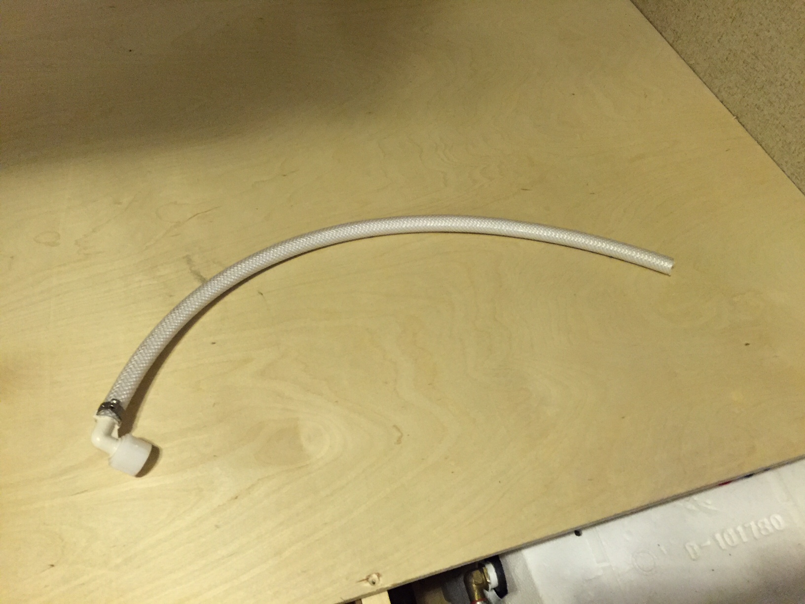

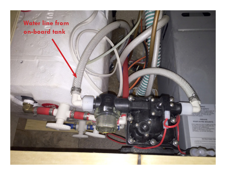

I pulled the cover off my bed and found the water pump and figured out what the extra hose was that was in my storage compartment. See image.
I assume I would unscrew the (in line) from my on-board water tank (see photo) and replace it with the short hose which I would put into my gallon of antifreeze. Then go through your winterizing suggestions.

Posts: 9062
Direct Link To This Post Posted: 19 Oct 2015 at 11:06am
The winterization checklist has been revised at the suggestion of Q7-retired. A few steps have been reversed to ensure the WH doesn't have pressure in it when you remove the anode rod.
It now mentions that some models didn't come with that short hose, and some require you to remove the water intake line. That wasn't true when the list was originally created.
