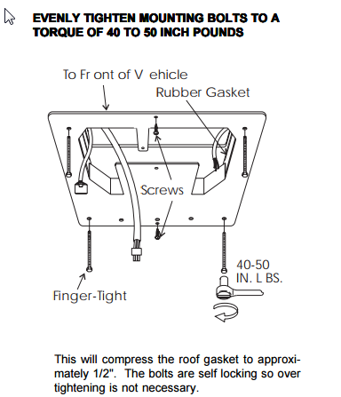

Just have to be careful about tightening the mounting bolts.  Compress the seal too much and you'll need to replace it.

Direct Link To This Post Posted: 12 Mar 2016 at 11:07pm
