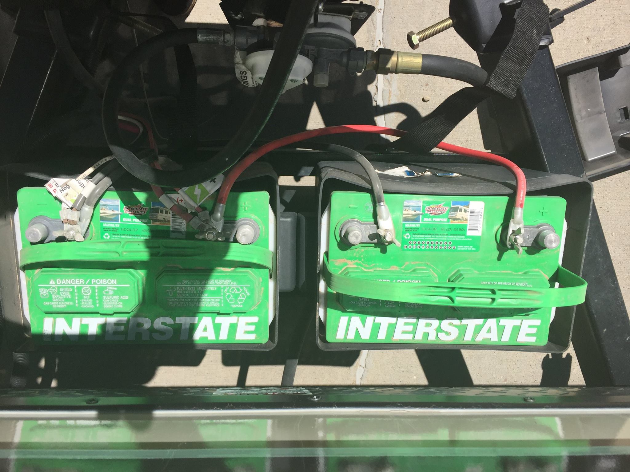

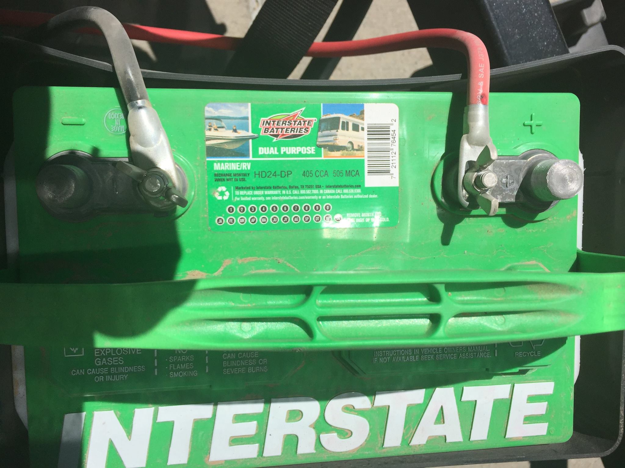

12 volt battery groups to choose from are (smaller to larger) 24, 27, 29, & 31. For a single battery setup, eventually, I was thinking I'd go with a group 29 (about $100 at Walmart). Previous trailer had two group 24s. Never ran out of power dry camping, but I hated replacing them every 4-5 years due to cost.
This is an older post... Not disagreeing with anything previously said. Just wanted to attach other options in case someone looked it up.
