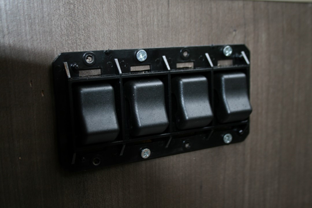

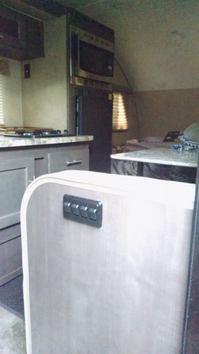

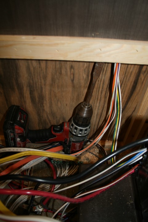

Did my first mod today,
I did not like having to climb into my 2016 180 Rpod to push the little button on a light in the dark to turn on one light and then wander around turning on other lights and sometimes knocking the covers off. I discovered that i could easily add a 4 gang RV switch just inside the door and control all the lights in the pod as i go in or out the door. Installing the switch took all of 45 minutes, all the wires for the lights are in the cabinet under the seat. I bought the black 4 gang switch on ebay for $14 with free shipping. I can still turn any light off and on with the button on each light for less or more light. If anyone wants more info let me know and i'll add a step by step pictorial. Here's a link to a video showing how it works. I added a step by step pictorial a few comments down d ![]() |

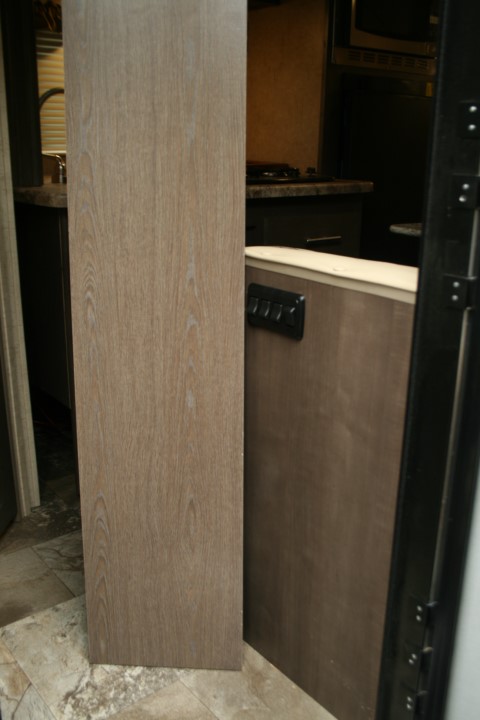

Thanks for the kind words! I'll take some pictures and put together a step by step. Did the video link work? I can't figure out out how to do a proper hyperlink. It was so inexpensive and easy I can't believe forest river did not do this from the factory! I'm not sure, but i think the electrical panel on a 179 is just inside the door to the right below the pantry door? The closer to the panel the easier the job is. The switch panel may fit between the pantry door and the panel or next to the panel sideways, or maybe on the wall facing the dinette, that would be the logical place for it. Either way it is a pretty easy project, low cost/high reward! Send a picture of the panel and walls around it and can let you know what i would do. |

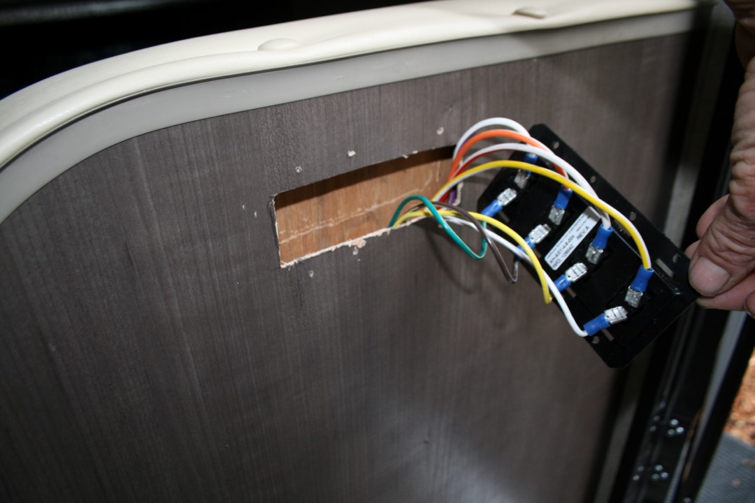

I would like to see the details as well, also, where did you get your switches? Did you reroute the wire from the light to the breaker to the switch and then run a new wire from the switch to the breaker/fuse?

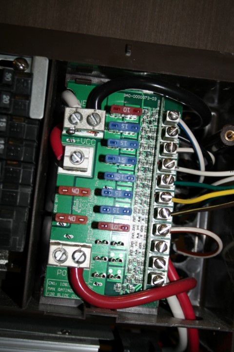

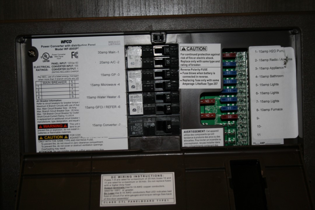

This morning I went out and took pics for a step by step on the switch install, And discovered a few things you may want to know.
Turns out the lighting fuses also run a few other things, so when you turn off the switch you may also turn off the power to a few other things, none of which are a deal breaker to me. I don't mind turning off a few puck lights occasionally to still use these other things when i need that. Fuse #4 - The Bathroom lights and Main cabin ceiling fan, (just turn off the puck lights and run the fan) Fuse #5 - Two rear main cabin lights and dinette lights. Fuse #6 - Sink light ( There MUST be something else but I cant find it). Fuse #7 - Front cabin light, bed lights, outdoor lights (2) AND the slide-out motor. (I turn on the switch when I need to move the slideout, or use outside lights) For instance when you turn off the Bed area lights using the switch you installed, it turns off the power the slide-out and the porch light and front utility light. In which case I turn on the switch when I need to move the slideout, or use outside lights. Same with the Bathroom lights switch, turning off the bath light switch also turns off the power to the Fantastic fan in the main cabin, so I just turn off the puck lights and run the fan. You could just install a single switch on fuse #5 or #6 just to light the place up when you go in. Here's the main electrical panel. Take off the two upper screws to remove the cover. and remove wires off fuses 4,5,6,7. You can see I used a 4 wire trailer wire, white, yellow, green,and brown (had it laying around). I removed the original wires from the screw terminals and pulled them out the back of the elec panel. and ran the new 4' long trailer wire through the same hole. I then drilled a 1/2" hole up thru the seat back, there is a 3/4' piece of wood you can feel up under the lip, this piece of wood lines up with the hollow gap between the 1/8" seat back and entry way panels. if I had to it again, i would drill this hole in the middle of the seat area and not near the front for the sake of wire pulling ease. I then cut the switch hole on the entry side. You can feel the area where there are no wood braces. I first drilled a 1/2" inspection hole and then marked the cutout 1/2 inch away from the wood braces knowing i needed space for connectors. I used a mini sawsall blade, but you can see it scored the wood behind it. I ended up using a utility knife to finish the hole, and would recommend you do it with a utility knife (cuts like butter). I then crimped terminals on and plugged them all into the switch and main panel. I tested everything and just moved wires around until i had everything where I wanted it, Bath lights on the left / entry lights on the right. You can see i bent the pins over on the back of the switches so it all would fit in the empty space, next time i would just buy angled terminals. I screwed in the switches and snapped on the cover. ![]() Hope this all makes sense, and I helped! Today i'm also Installing a shelf over the bedroom window. Because i found this at Home Depot, almost a perfect match! Cheers, John |
